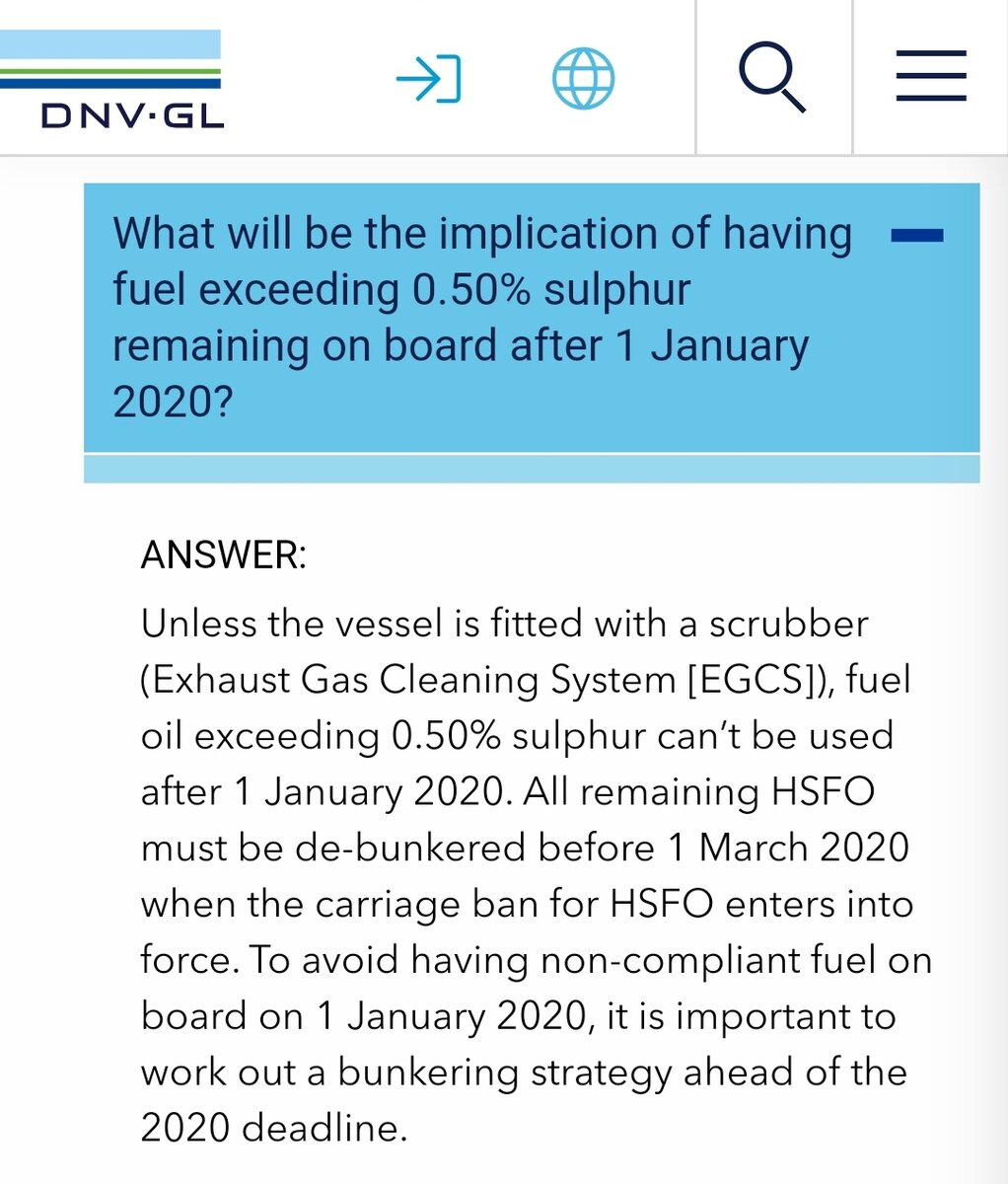

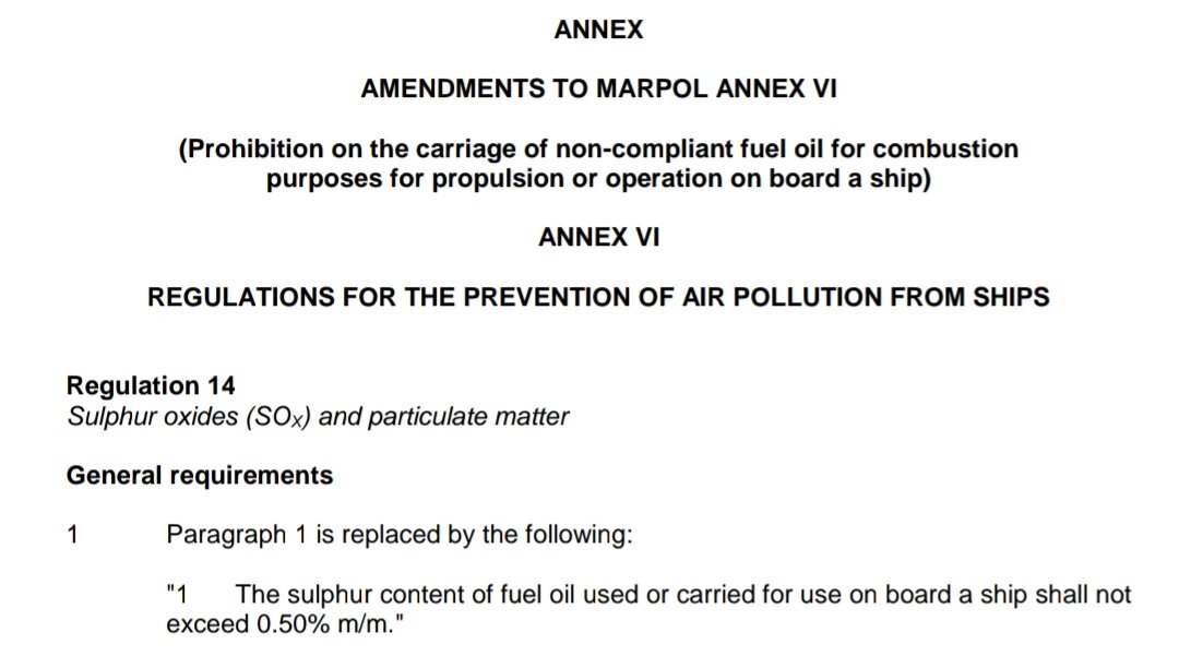

enas chiotis Posted January 20, 2020 Posted January 20, 2020 Από 01/03/20, στις περιοχές Paris & Tokyo MOU, θα απαγορεύεται να μεταφέρεις και μη συμβατό καύσιμο στις δεξαμενές σου, εκτός αν έχεις scrubber. Quote Prohibition on the carriage of non-compliant fuel The Tokyo and Paris Memoranda of Understanding (MoUs) on port State control (PSC) have been working collaboratively to ensure that vessel owners and operators are aware that under the Authorities belonging to these MoUs, inspections will be undertaken to ensure compliance with the new sulphur limit requirements on marine fuel oil, from 1 January 2020. These new requirements prohibit the use of non-compliant fuel from 1 January 2020 and the carriage of non-compliant fuel, for use on the ship, from 1 March 2020, unless the ship is fitted with an Exhaust Gas Cleaning System (EGCS). To raise awareness in advance of the implementation of the new requirements, both the Paris MOU and the Tokyo MOU member Authorities have been issuing letters to vessels since the beginning of 2019, to remind them of the new requirements and the date of application. During this information campaign the awareness among ships’ crew proved to be high, especially with respect to the requirements entering into force on 1 January 2020. Emphasis is therefore placed on the requirements entering into force on 1 March 2020 prohibiting the carriage of non-compliant fuel, for use on ships not equipped with EGCSs. As noted in these letters, there are three options for ship owners and operators to comply: Use compliant fuel oil with sulphur content not more than 0.50% m/m; Use an alternative fuel, such as LNG, with a sulphur content of 0.50 % m/m or less; or Fit an alternative means of compliance, such as an EGCS approved under regulation 4 of MARPOL Annex VI. The consensus at MEPC 73 was that there was no need to request port State control Authorities to adopt a ‘practical and pragmatic’ approach as compliance was expected, therefore both Memoranda have agreed that the requirements in relation to the implementation of the 0.50% m/m sulphur cap will be applied without exception. This includes the carriage ban on non-compliant fuel from 1 March 2020. From 1 March 2020 non-compliant fuel can only be carried on board, for use on the ship, where the vessel is fitted with an EGCS. In instances where compliant fuel cannot be obtained a Fuel Oil Non-Availability Report (FONAR) must be submitted to the flag State and the Competent Authority in the next port of call. parismou.org

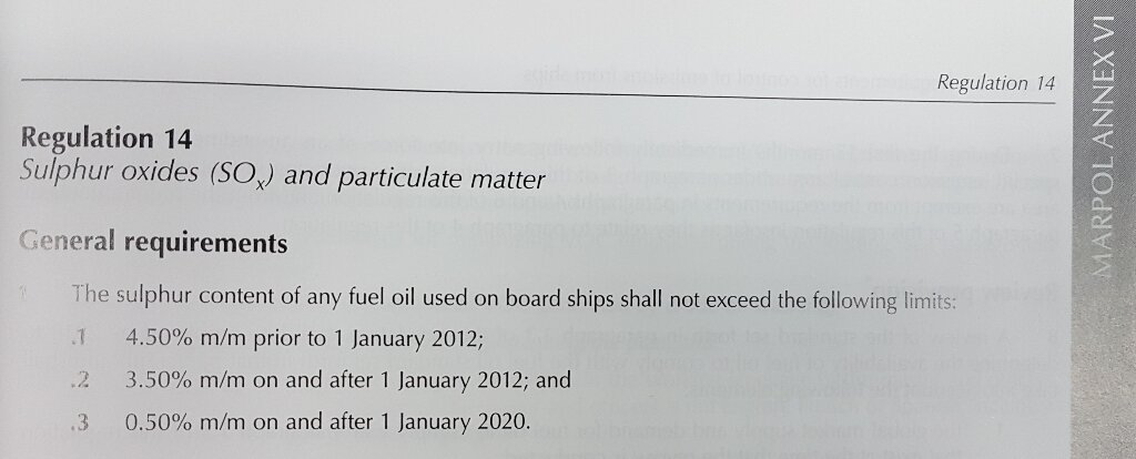

Nick the Greek Posted January 20, 2020 Posted January 20, 2020 On 1/4/2020 at 11:40 PM, Annivas said: Εξ' όσων γνωρίζω οι υφιστάμενοι κανονισμοί και διατάξεις δεν απαγορεύουν τη δυνατότητα χρήσης όλων των τύπων καυσίμου (μέχρι περιεκτικότητας σε Θείο 3,5%) ακόμη και όταν δεν είναι όλες οι μηχανές συνδεδεμένες με σύστημα scrubbers. On 1/5/2020 at 7:39 AM, Nikos_Chania said: Η εταιρεία οφείλει να συμμορφώνεται στους κανονισμούς. Για να είναι συμμορφωμένη οφείλει να έχει και τις 4 μηχανές συνδεδεμένες σε scrubber. Δεν είναι απαραίτητο να έχει 4 scrubber, αλλά είναι απαραίτητο όλες οι μηχανές να είναι συνδεδεμένες σε scrubber. On 1/10/2020 at 8:54 PM, Nick the Greek said: Συμφωνώ, γίνεται τεχνικά. Δεν είναι απλό αλλά γίνεται. Πέραν των παραπάνω, πρέπει -προφανώς- τα καύσιμα με τις 2 περιεκτικότητες σε θείο να αποθηκεύονται σε διαφορετικά storage tanks, αλλά και να καίγονται μέσω διαφορετικού service/settling tank γιατί δεν γίνεται να αναμειχθούν. Με ιντριγκάρισε πολύ η παραπάνω αντιπαράθεση, αλλά είπα να επιβεβαιώσω την προσωπική μου γνώμη με ανθρώπους που ξέρουν πολύ περισσότερα από μένα, πρίν την εκφράσω. Πηγή μου λοιπόν είναι ένα υψηλόβαθμο στέλεχος ενός εκ των 3 μεγαλυτέρων και αξιόπιστων νηογνωμόνων(ας μην κάνουμε διαφήμιση) που συμμετέχει και στις διεργασίες του ΙΜΟ. Το ρεζουμέ είναι πως αυτό που λέει ο Annivas γίνεται, τόσο τεχνικά όσο και σε επίπεδο κανονισμών. Δυστυχώς δεν είχα τη δυνατότητα να βάλω τον συγκεκριμένο άνθρωπο να μου αναφέρει και τα σχετικά εδάφια των κανονισμών(όπως πολύ επιμελώς συνήθως παραθέτει ο φίλος Nikos_Chania), έχει άλλωστε πιο σοβαρά από μένα να ασχοληθεί. Μου ανέφερε σαν παράδειγμα τα boilers, πολλά πλοία δεν συνδέουν τα boilers με το scrubber. Πρέπει όμως να έχουν compliant fuel γι αυτά. Ένα άλλο παράδειγμα που μου ανέφερε είναι οι ηλεκτρομηχανές και η συμμόρφωση με τα NOx Tier III, μπορούν μόνο δύο από τις τρείς να είναι NOx Tier III. Αυτό που πρέπει να γίνει όμως σύμφωνα και με τις οδηγίες του ΙΜΟ πρός τα Port State Controls, είναι τα πλοία με διαφορετικούς τύπους καυσίμων να έχουν στην εντέλεια τα σχετικά έγγραφα και αποδεικτικά για το πού καίγεται τι. Με λίγα λόγια, αν το Oil Record Book είναι ύποπτο, το πλοίο και ο πλοιοκτήτης θα έχουν πρόβλημα. Εκεί που εφαρμόζονται σωστά οι κανονισμοί βέβαια, κι όχι επιλεκτικά. Επαναλαμβάνω για να μην παρεξηγούμαι, τι ακριβώς έχουν κάνει οι Μινωικές δεν γνωρίζω, σχολιάζω μόνο ως πρός την δυνατότητα να το κάνουν. Μια που λέμε για εφαρμογή κανονισμών, οι πρώτες πληροφορίες που έχουν φτάσει στ' αυτιά μου αλλά και έχουν γραφτεί, είναι πως πλήν της Κίνας δεν υπάρχει ακόμη καμία σωρεία παραβάσεων των κανονισμών. Ακόμη και στην περίπτωση της Κίνας, οι λίγες περιπτώσεις(4-5) που έχουν δεί το φως της δημοσιότητας αφορούσαν πλοία τα καύσιμα των οποίων ξεπερνούσαν οριακά την προβλεπόμενη περιεκτικότητα σε Θείο, με τα πρόστιμα να εκτείνονται από 1500 ως 15 χιλιάδες δολλάρια. Περίπτωση όμως που το πλοίο να καίει 3.5% S καύσιμο χωρίς scrubber, δεν έχει ακόμη επιβεβαιωθεί. Σίγουρα υπάρχει, απλά δεν τους έχουν πιάσει. Κάτι άλλο που μέχρι στιγμής δε φαίνεται να επιβεβαιώνεται, είναι οι έντονοι φόβοι των Ελλήνων(αλλά και άλλων) πλοιοκτητών όσον αφορά την πιθανότητα μαζικών προβλημάτων καύσης του καινούριου καυσίμου και περί "δεκάδων πλοίων που θα έμεναν ακυβέρνητα στη μέση των ωκεανών". Υπάρχουν προβλήματα σε ορισμένες περιπτώσεις που αφορούν την υπερβολική παρουσία sludge, με τα φίλτρα και άλλα εξαρτήματα να πρέπει να καθαρίζονται ενδελεχώς προκειμένου να γίνει σωστά η καύση. Πλήν όμως σε καμιά περίπτωση -μέχρι στιγμής- στο δραματικό τόνο που ήθελε η ΕΕΕ να προσδώσει. Μην ξεχνάμε πως πολλά πλοία έχουν συμμορφωθεί ήδη από τα τέλη Νοέμβρη, οπότε μιλάμε για ένα αρχικό δείγμα 2 μηνών σχεδόν. Η ελληνική τρομολαγνεία στο συγκεκριμένο θέμα, αποτελούσε ήδη πρίν την εφαρμογή αντικείμενο μειδιάματος στα διεθνή fora, τώρα πια που έχουμε τα πρώτα θετικά δείγματα της εφαρμογής, αφήνω τα σχόλια στη φαντασία σας. Εκεί που βέβαια έχουν ένα δίκιο οι Έλληνες(αλλά και άλλοι) πλοιοκτήτες είναι πως η όλη μελέτη για την μετάβαση, έγινε βιαστικά και υπό το βάρος πολιτικών πιέσεων. Αυτό φαίνεται να αποδεικνύει μια μελέτη που κυκλοφόρησε πρόσφατα, μελέτη η οποία ήταν εντεταλμένη από τη Γερμανία και τη Φινλανδία. Η συγκεκριμένη μελέτη αποδεικνύει πως μπορεί μεν η περιεκτικότητα σε θείο να μειώνεται, πλήν όμως έχουν αυξηθεί από 10 εώς και 85% οι εκπομπές black carbon(αιθάλης αν το μεταφράζω καλά), σαν αποτέλεσμα του πολύ αυξημένου αρωματικού χαρακτήρα(με τη χημική έννοια του όρου) των καινούριων καυσίμων με περιεκτικότητα 0.5% Θείο. Αυτό έδωσε το έναυσμα σε 4 ΜΚΟ σχετικές με το περιβάλλον να ζητήσουν κατεπείγοντα μέτρα από τον ΙΜΟ έτσι ώστε σε ευαίσθητες περιοχές όπως η Αρκτική, να απαγορευθεί εντελώς η καύση residual fuels. Να καίνε δηλαδή τα πλοία αποκλειστικά και μόνο gasoil. Επισυνάπτω και το σχετικό έγγραφο από τον ΙΜΟ, για όσους θέλουν να πονέσει το κεφάλι τους. Οπότε η επόμενη Σύνοδος του ΙΜΟ αναμένεται με εξαιρετικό ενδιαφέρον. (συμπαθάτε με για το σεντόνι που έγραψα) PPR 7-8-3 - The need for urgent action to stop the use of blended low sulphur residual fuels leading t... (FOEI, WWF, Pacific Enviro...).pdf
Nikos_Chania Posted January 21, 2020 Posted January 21, 2020 Μέχρι να μπορέσω να βρω χρόνο και όρεξη να παραθέσω όσα περιγράφουν οι κανονισμοί, ας μας ενημερώσει καποιος πόσα service & settling tanks μπορουμε (ή έχουμε ήδη δει) να συναντήσουμε σε ένα πλοίο ώστε να δικαιολογήσουμε την ταυτόχρονη χρήση 2 καυσίμων κατά τα ανωτέρω; On 1/5/2020 at 8:39 AM, Nikos_Chania said: Όλα τα βαπόρια έχουν μαξιμουμ 0.5% εκτός αν εμπίπτουν στον κανόνα 4 που αναφέρει τα equivalents. Δεν θα παραθέσω εδώ ούτε MEPC, ούτε amendments, κι ούτε είναι εφικτό. Self explanatory και επειδή στη βράση κολλάει το σίδερο, με τη RESOLUTION MEPC.305(73) τον Οκτώβρη του 2018 έγινε τροποποίηση της παραγράφου που παρέθεσα (αλλά δεν μπορουσα τότε να βάλω το amendment) και ορίζεται πλέον και ως carriage limit. Επίσης τι μας λέει ο DNV? Παρ όλα αυτά, η ανάγνωση των κανονισμών θέλει προσοχή για τα όποια παραθυράκια φέρει. Όπως για παράδειγμα το τι θα συμβει αν υπαρξει προβλημα στη μονάδα scrubber. Με circular τον Μάη του 2019 (MEPC.1/Circ.883) ορίζονται μερικές ενέργειες σε οποιαδήποτε βλάβη. Συνοπτικά φίλοι συνάδελφοι να σας πω οτι εχετε μία ώρα στη διάθεσή σας να φτιάξετε τη scrubber ή να αλλάξετε καύσιμο, αν έχετε, σε <0.5%. Διαφορετικά πρέπει να εφοδιαστείτε ή να έρθει συνεργείο. Αυτά για την ώρα, ελπίζω να κάλυψα αρκετά κομμάτια.
