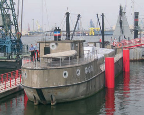

ΝΗΡΕΑΣ Posted September 28, 2006 Posted September 28, 2006 Στην επιθεώρηση SHIP REPAIR JOURNAL, APRIL/MAY 2006 υπάρχει ένα άρθρο σχετικά με νέες τεχνικές και υλικά στην κατασκευή πλοίων από οπλισμένο σκυρόδεμα. Το παραθέτω, ως έχει στο πρωτότυπο, και ας το σχολιάσουν ή και να το συμπληρώσουν οι καθ' ύλην αρμόδιοι : Concrete shipsFirst it was Intelligent Engineering’s awardwinning Sandwich Plate System with its composite solution for ship repairs and construction. Now it’s a concrete sandwich from Norwegian classification society DNV! The idea of using a sandwich design of steel surface plates and a lightweight concrete core was conceived by Dr Pål Bergan in DNV Research’s labs about five years ago. Such was the strength of his idea that it was further developed in a strategic research project with Aker Yards ASA, in which DNV focused on technology development and Aker Yards studied the potential for efficient fabrication and different types of ship applications. Successful laboratory tests of component fatigue and strength have apparently shown that such a design is in many ways superior to today’s welded steel structures. According to DNV a ship built from the steel/concrete sandwich has the potential to offer several new safety features. For instance, a cellular hull structure means more barriers against water ingress. In effect, four steel plates would have to be cracked or penetrated for water to leak into the cargo space, as opposed to only two barriers with a conventional double hull. DNV says during tests the system showed remarkable ability to absorb energy and withstand accidental loading, such as explosions, collisions and groundings. Lightweight concrete is also a good heat insulator; it’s non combustible and, because there’s less exposed surface area, there is less corrosion and structural degradation – and less paint required, says DNV. However, there is a flaw: weight. As some readers may recall concrete was used in shipbuilding during the first and second world wars, when steel was at a premium. During peace time, though, shipbuilders and shipowners rejected it in favour of lighter materials due to problems associated with weight. Things change. The concrete ships of the past used normal reinforced concrete which carried a weight penalty of more than 50 per cent compared to steel ships. So a major aim of the project was to find or develop a strong but lightweight concrete mix. It was found aggregates like Liaver and Liapor do the job and produce good structural concretes with a mass density of less than 1000kg/m3. (This means the concrete will float in water.) In a review of DNV’s research throughout 2005, Kåre Baken and Dr Bergan’s report states that a series of sandwich beam specimens have already been tested statically and dynamically according to the requirements. Fatigue testing has been carried out for a variety of load conditions. With respect to resistance to initial cracking, DNV reports positive results. Moreover, DNV Research said no material disintegration at cracks that were exposed to millions of additional cycles was detected. A typical shear crack specimen has a jagged geometry, implying that extensive shear interlock exists and that shear forces can still be transferred along the crack after it has developed The project is now entering a new and exciting phase, extending co-operation in research and development as well as commercial use of the technology. DNV Research claims the test result so far confirm that this could be an entirely new way of building or repairing ships. _ Το άρθρο συνοδεύει η φωτό ενός τσιμεντόπλοιου (δείτε την συνημμένη εικόνα) με την λεζάντα: The concrete constructed Capella, built in 1943 is still afloat and in excellent condition at the maritime museum of Rostock. Πληροφορίες (στα Γερμανικά) για την ιστορία και τα τεχνικά χαρακτηριστικά του Capella, μπορείτε να βρείτε εδώ .

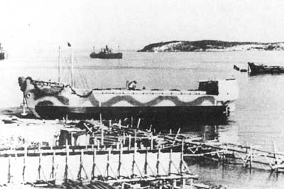

byron Posted January 6, 2008 Posted January 6, 2008 Θα πρόσθετα κ`εγώ λίγες πληροφορίες που βρήκα σ`ένα γερμανικό πολεμικό ημερολόγιο για τα τσιμεντόπλοια που κατασκευάστηκαν από τους Γερμανούς τον καιρό της κατοχής. Το ναυπηγείο ήταν πράγματι στο Πέραμα με υπεύθυνους τον Γερμανό αντ/ρχη του Μηχανικού Γκέτσε και τον υπασπιστή του Λ/γό Έρνστ Αρνόλντι Baultg. b.Gen. : 12.1943 Obstlt. Götsche (Stahlbeton Schiffsbau, Werft in Perama, Fp.Nr 40 359) Adj.: bis 05.10.44 Hptm. Ernst Arnoldy (bis 05.10.44 beim Schiffsbau Götsche) Τα πλοία που κατασκευάστηκαν δεν ήσαν πολλά, αυτά που βρήκα ήσαν General Meise I-V (5 πλοία), General Jakob I-III (3 πλοία), General Förtsch, Pionier I-IV (4 πλοία), Alfred, Achilles, βυθίστηκε 08.10.44, Nicolina Madre, St.Gotthard και Enrichetta Maddalena Πιθανόν να κατασκευάστηκαν και άλλα που δεν γνωρίζω Ανοίκαν όλα στη Mittelmeer Rederei
ΝΗΡΕΑΣ Posted May 8, 2009 Posted May 8, 2009 Σε συνέχεια όσων αναφέρει προηγουμένως ο Βύρων, βρήκα και άλλα στοιχεία για τα γερμανικά τσιμεντόπλοια. Στο βιβλίο του Peter Schenk «Πόλεμος στο Aιγαίο, 1941-1945», Εκδόσεις EUROBOOKS, Αθήνα 2008 (τίτλος πρωτοτύπου “Kampf um die Agais”, 2000) υπάρχουν πάρα πολλές φωτογραφίες (από γερμανικά αρχεία) με γερμανικά πλοία και από επιχειρήσεις στο Αιγαίο κατά την περίοδο του πολέμου, τις περισσότερες από τις οποίες δεν τις έχω ξαναδεί. Και βεβαίως έχει και αρκετές πληροφορίες (συνοπτικές όμως και αποσπασματικές) από την οργάνωση και δράση του γερμανικού ναυτικού στο Αιγαίο. Στο βιβλίο υπάρχει και μια μικρή αναφορά στα τσιμεντόπλοια που κατασκευάσθηκαν στην Ελλάδα: Ένας ακόμη ναυπηγικός κύκλος άνοιξε το φθινόπωρο του 1941, όταν δόθηκε η παραγγελία κατασκευής των πλωτήρων από σκυρόδεμα ΑΟΚ ΧΙΙ, για μία πλωτή γέφυρα μήκους δύο χιλιομέτρων. Αφότου εξέλειπε η ανάγκη για αυτήν την γέφυρα, οι πλωτήρες αυτοί μετασκευάσθηκαν σε μεταφορικά πλοία 300-500 τόνων. Τα πλοία δοκιμάσθηκαν αρχικά το φθινόπωρο του 1943 σε παράκτιες κινήσεις. Στις 28 Ιουνίου 1944 το σκάφος «General Meise IV» διεξήγαγε την πρώτη επιχείρηση του στην ανοικτή θάλασσα, πλέοντας από τον Βόλο στην Χαλκίδα και αποδείχθηκε επαρκώς αξιόπλοο. Έπρεπε μόνο να οδηγείται προσεκτικά κατά τους ελιγμούς προσορμισμού. Συνολικά αποδόθηκαν σε υπηρεσία κάπου 14 τέτοια σκάφη, τα οποία νηολογήθηκαν από την Μεσογειακή Εταιρεία Ναυσιπλοϊας. Τέλος, στο βιβλίο υπάρχει και μια σπάνια φωτογραφία από την καθέλκυση του τσιμεντόπλοιου «Pionier I» στο Πέραμα.
byron Posted May 8, 2009 Posted May 8, 2009 @ NHREAS Πράγματι και σε μένα είναι γνωστά δεκατέσσερα μπετονόπλοια που τα αναφέρω και στη νέα έκδοση του βιβλίου μου, ως κάτωθι: Μπετονόπλοια της μεσογειακής εταιρείας ναυσιπλοiας: Διεύθυνση., 12.1943 Συντ/ρχης. Götsche (Stahlbeton Schiffsbau), Ναυπηγεία Περάματος Υπ/στής., Λ/γός Ernst Arnoldy (έως 05.10.44) Ονομασία πλοίων “General Meise” I-V, (? 08.10.44 βυθίστηκε από βομβαρδισμό στο Κανάλι της Εύβοιας.), “General Jakob” I-III, “General Förtsch”, “Pionier” I-IV, “Alfred”, “Achilles” 08.10.44 βυθ., “General Lambert”, 16.10.44 βομβαρδίστηκε στο λιμάνι του Βόλου “General Herrmann” (δοκιμάστηκε το Φθινόπωρο 1944) Δεν νομίζω ότι τα σκάφη προέκυψαν από τους πλωτήρες κάποιας προγραμματισμένης γέφυρας. Αυτό δεν αναφέρεται σε κανένα ημερολόγιο. Τουναντίον τονίζεται η επίγουσα ανάγκη κατασκευής πλοίων και λόγω έλλειψης άλλων υλικών και δυνατοτήτων, κατασκέυασαν αυτά από μπετόν.
