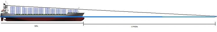

Angelos Posted April 27, 2007 Share Posted April 27, 2007 gia thn oratotha yparxei enas aplos typos L+L/2 opou L to mhkos tou ploiou. O skoteinos tomeas den prepei na 3epernaei auto to mhkos. Akoma kai to meso ypsos tou Helsman ypologizete wste na paroun oso perissotera containers einai dynaton. Brhka mia aplh photo kai ekana ena mikro sxediaki gia na to e3hghsw. Den metrhsa an pragmatika h grammh pou bgainei einai oso leei to sxedio mia kai h photo tou container den 3erw poso metrhmenh einai. An exei bgei kapoia e3airesh gia ta ypermegala ploia, den 3erw. Pantws o above typos einai sigoura to base rule. Link to comment Share on other sites More sharing options...
