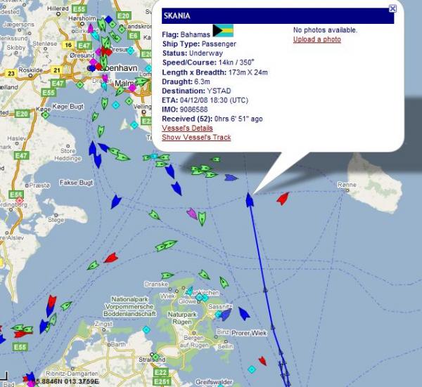

Σύμφωνα με αυτή την πηγή, το SKANIA πήρε μαζί του το αλιευτικό GITTE 12.
173-m, 23,663-gt Skania (former Superfast I, IMO 9086588), Polish port Swinemunde to Ystad in Sweden, collided with German F/V Gitte 12 miles east of Ruegen Island, Germany, on Feb. 17 at 0120LT. The ferry continued its voyage after the end of investigations by the Neustadt police. In Ystad a thorough damage survey will take place. The Gitte was advised to enter the port of Sassnitz, having lost its anchor, anchor chain as well as parts of its railing.
Από τον ρουφ μας, το πλοίο φαίνεται να κάνει δρομολόγια, οπότε δεν πρέπει να είναι κάτι το σοβαρό.
